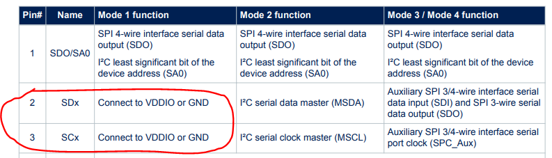

Hi @anne ,
As you can see in the datasheet p.7, if you are working in Mode 1, you don't need these two pins and, since they are configured by default as high impedance, you can connect them either to Vdd or to GND.
In general, a good practice would be to connect them to the application processor, so that they can be used in the future for other unforeseen applications.
-Eleon
