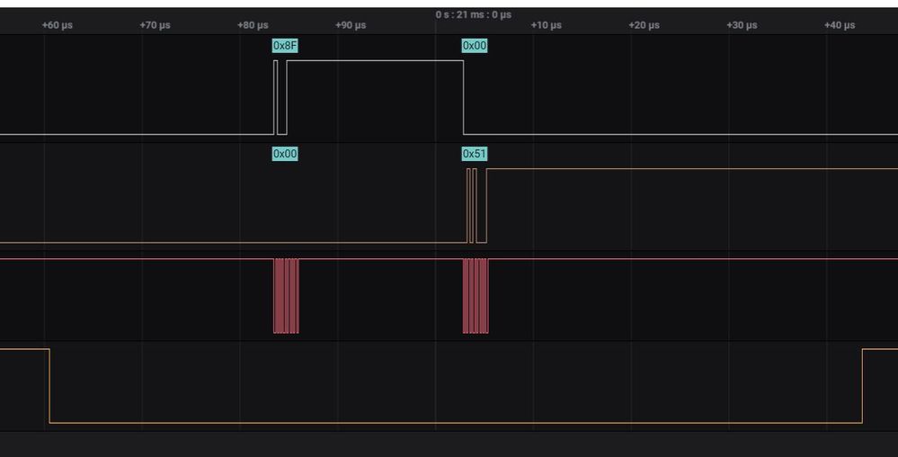

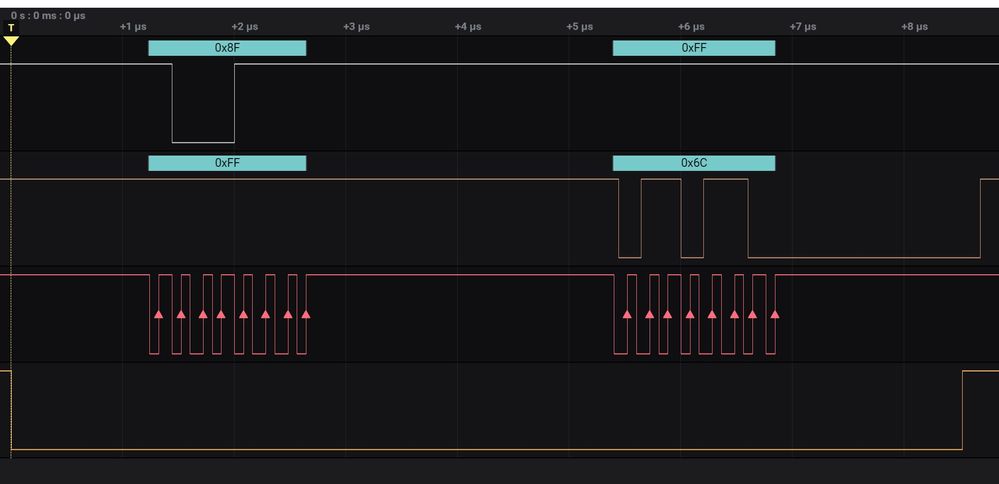

I'm still chasing the problem of SPI reads after many hours of work. I compare data from a Nucleo-L053R8 board with a LSMD6SO IMU to data from the STEVAL-MK1109V3 development tool and the LSM6DSO. The development tool gives the correct response from the "Who Am I" register as 0x6C. The Nucleo board does not. The "resting" state of the MISO and MOSI lines are also different although I don't know if this should matter. I am also concerned that the development tool reads or write all 40 registers when the menu tab that displays the registers is selected. I'm not sure really what is needed to get to a reliable state for reads or writes. I can't find anything in documentation about this. I attached the code and waveform captures from the development tool and Nucleo board. Should I consider switching to I2C?0693W00000DnZ6TQAV.jpg0693W00000DnZ6OQAV.jpg
