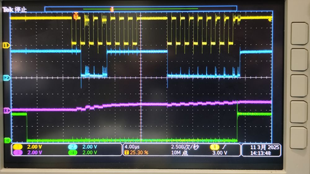

(2)SPI communication issue
SPI_SCK and SPI_MOSI signal is correct but SPI_MISO has no signal.
I configured STM32H743XIH6 SPI in STM32CubeMX like this. No NVIC, no DMA.
I implemented the SPI polling read/write function for official ST LSM6DSV driver code.

The following picture is SPI communication to read LSM6DSV's ID. SCK(yellow), MOSI(blue), MISO(purple), CS(green). The MISO line has no signal.
I tried HAL library but I got no signal on MISO either.

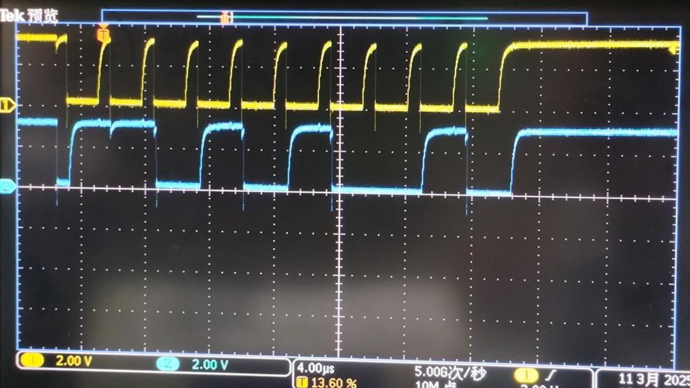

(3)I2C communication issue
I got NACK signal from LSM6DSV and the I2C communication was stopped after sending the I2C slave address.

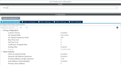

STM32CubeMX configuration. No NVIC, no DMA.

The signal of I2C communication to read LSM6DSV's ID but got NACK after sending slave address. I used STM32H7 development board so there is no pull up register on SCL and SDA.
