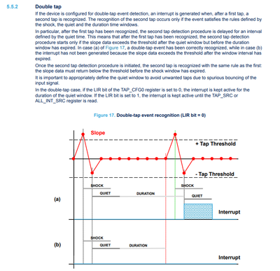

The procedure to detect the double tap is described at page 48 of AN5192:
Are you doing the test in this way?
