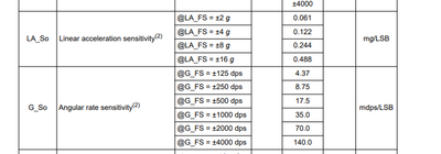

Hi @semiconductor_user ,
You get the raw data in LSB, then you multiply it by the sensitivity 0.061 mg/LSB and you will get the data in mg.
If you need the output in g you need to divide them by 1000.

Federica Bossi
Please refer to the DS12374, at page 14 you find the sensitivity for each full scale to be used to obtain the outputs in g or dps.

that i know what is sensitivity factor of ±2g full scale, it is 0.061 but how to use this 0.061.
my Questions is,
1.whatever data i'm getting as raw value that is mg/Lsb or g ?
2.if raw value is mg/LSB so what is a formula for conversion from mg/LSB to g ?
