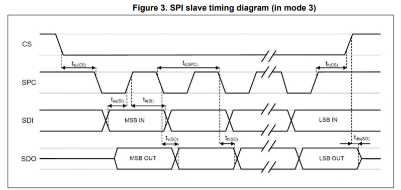

Hi @SWenn.1​ ,
As shown in the datasheet p, the working SPI Mode is Mode 3, i.e. with CPOL=1, CPHA=1:
