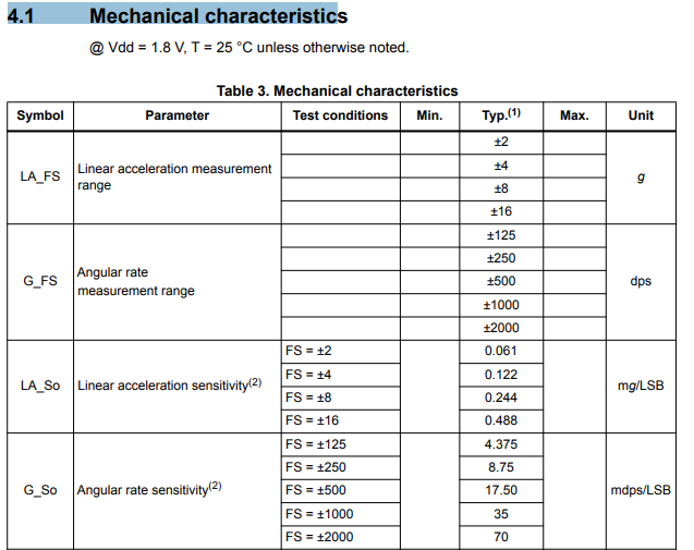

The data is in 16 bit two's complement which means that for example your reading is not 65423 but actually -113, which multiplied by sensitivity for FS 2g 0.061 equals -6.893 mg which is very close to zero. Another example of your data 16076 * 0.061 = 980.636 mg which is almost 1 g.

In order to interpret the data, you also need to know the range you selected, which affects sensitivity. See section 4.1 Mechanical characteristics in the datasheet. https://www.st.com/resource/en/datasheet/lsm6dsl.pdf
