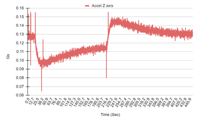

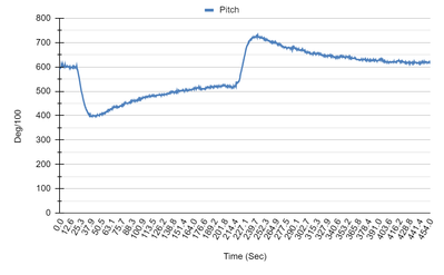

We are using LSM6DSL for one of our products and in that we have noticed that the Z-axis Accelerometer deviates due to change in temperature for a stable orientation as shown below which is affecting pitch of the product by -1 to -2 deg.

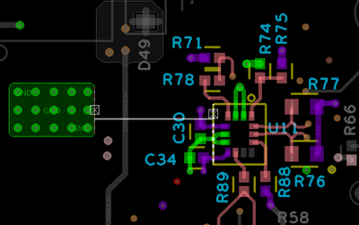

The IMU is placed near a LED driver which changes its brightness from 20% to 100%. The layout image shows the distance (7.5mm shown in thin silver line) between the thermal vias of the LED driver(which is in bottom layer) and IMU (in top layer). The entire board is potted with a thermally conductive epoxy material.
As shown in the graph,
1. Initially from 0 to 20 sec it is in 20% brightness (LED driver dissipates less heat) at 130 milliG.
2. At 20sec, we switch the driver to 100%. We see that the due to sudden change in temperature by 1 deg the Z-axis accelerometer immediately shifts down by 30 milliGs (130mG to 100mG) and then slowly tend towards to its original value.
3. At 225sec we switch the driver back to 20% and the Z-axis accelerometer immediately shifts up by 30 milliGs (115mG to 145mG) and then slowly tend towards its original value.

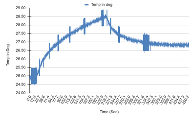

From temperature graph we can see that the max change in temperature, that too over the entire period not immediately is 3.5 deg (25 deg to 28.5 deg) and according to datasheet

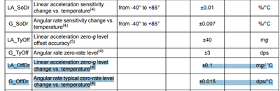

the change in linear acceleration vs temperature should be only 0.1 mg/deg, which in my case should be ±0.1 mg/deg*3.5 deg = ±0.35mg instead of 30mg which we are seeing.
