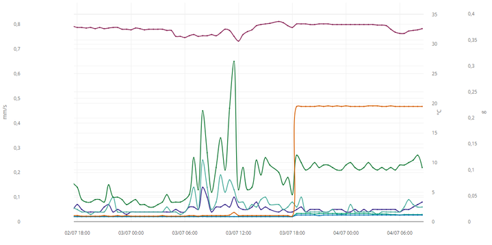

Here is the screenshot of the RMS data. You can see that after 18:00 yesterday, 07/03, there is a DC level in the acceleration of the Z-axis, and also an offset in the Z-axis velocity. This axis is being influenced by gravity.
Attached are the raw data collected just now from the Z and X axes. I wanted to send the Y-axis data as well, but it is not allowed by the forum. From 18:00 until now, the offset remains, but sometimes it lasts only a few hours or minutes and then returns to normal.
Through the raw data, it is possible to observe the described behavior, with the value 2560 among valid raw data for the Z-axis, and the value 0 among valid raw data for the X-axis.
