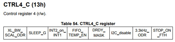

Normally the I2C device on SPI bus is not a problem, but you can disable the I2C interface using I2C_disable bit in CTRL4_C register.
