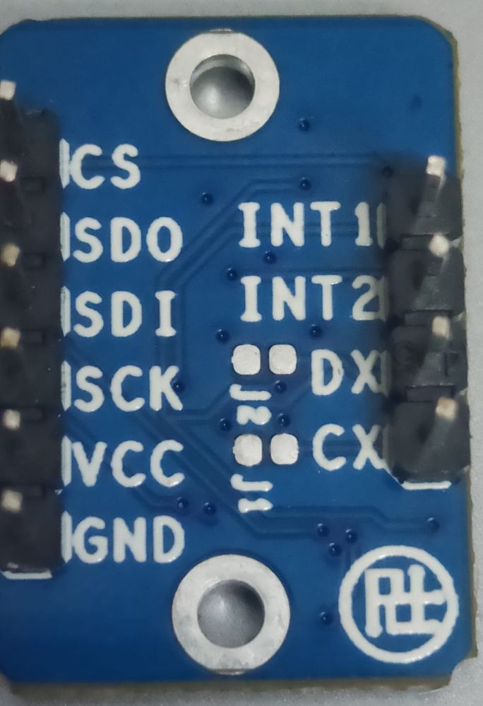

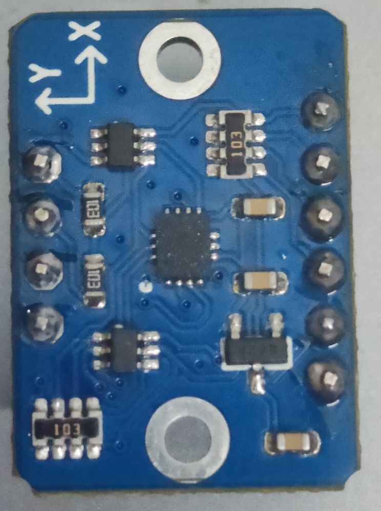

I recently bought LSM6DS3TR-C sensor from local market. I tried to measure the accelerometer using Adafruit_LSM6DS and SparkFun_LSM6DS3_Arduino_Library library. In both case the sensor was not recognized. I found the sensor was working. It responded to my I2C communication. The identification register aka WHO_AM_I register held the value 0x6A. I am new in this area. Is the sensor the right one. Is there any easy library for reading accelerometer data from the sensor? I am attaching the sensor's picture. Your help will be very much appreciated.

RhSilicon
Lead
Compare your board schematics with the schematics of boards produced by SparkFun and Adafruit.

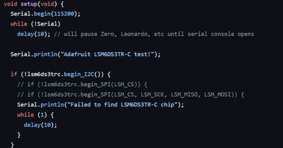

This portion of the code is executed and it prints "Failed to find LSMD63TR-C chip". This is the github link: SparkFun_LSM6DS3_Arduino_Library
My code is straight forward. It uses wire and finds the address:
