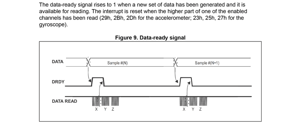

In section 4.3, page 37, the appnote says:
That's pretty explicit: DRDY should be deasserted when register 0x29 is read. At the bottom of this figure you can see that it illustrates the trailing edge of DRDY at the *end* of the X axis data transfer, which makes sense because X's data is in registers 0x28 and 0x29.

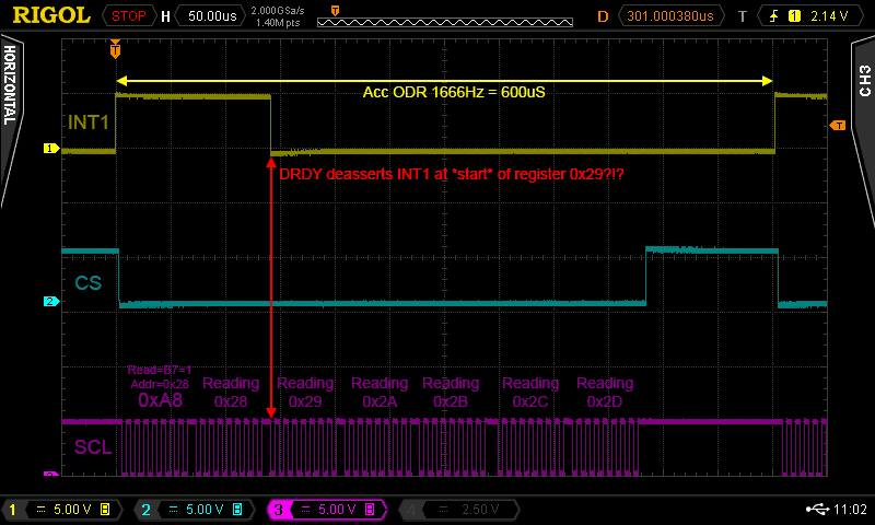

Now look at what the LSM6DS3 actually does on a scope:
The bottom trace is SCL (not MOSI), so you can see the individual clock pulses. The red arrow shows how INT1, which is being driven by DRDY (INT1_CTRL/0x0D = 0x01), deasserts not at the end of the X axis data, but between the two bytes of X axis data. This directly contradicts the appnote figure above. Is this behavior controlled by a flag somewhere?

Yes, DRDY was always set properly. The question was one of timing... what the appnote says is NOT what actually happens, as my original post above illustrates. However, extensive testing has shown that INT1 does work - just not as the appnote describes - and we have been able to make progress.
