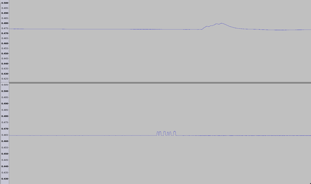

I've had this problem with an ILPS22QS and now I'm having it with an LPS22HH. It has me completely mystified. The issue is like this: The pressure sensor works as normal for a week or even multiple weeks and then all of a sudden it enters a mode where it no longer reacts to pressure changes properly. Instead it looks more like a capacitor where pressure peaks increase the value of the sensor and if there are multiple in quick succession they add up. Once the pressure goes back to environmental pressure the value slowly goes down. A picture illustrates this better. The picture is a recording of pressure values from 2 sensors of type LPS22HH on the same PCB. They've both been working fine for about a week now. Today one of them entered the weird-mode. Power-cycling does nothing. I've unplugged and replugged the PCB multiple times. The firmware of the PCB has not been changed, nor does it have non-volatile memory that could change its behavior. For both pressure sensors I take a drinking straw and blow on the sensor a few times in quick succession. The lower trace is what I expect. It's what I've seen every time I've done this test with LPS22 type sensors. This trace is from the sensor on the PCB that still works. The upper trace is the reading from the weird-mode sensor. As you can see the individual blows stack up and then slowly drain out.
What could be responsible for this behavior?

I may have spoken too soon about it not being related to dirt. By pure coincidence when I was assembling a new unit from a PCB that I had verified to be working, immediately after assembly, one of the sensors malfunctioned in the above manner. I had a hunch that it might be related to me touching the sensor with a silicone seal during assembly. I brushed the silicone seal over a working sensor and was able to induce the weird behavior. I didn't see anything on the sensor under a magnifying glass except for some dullness. I was able to restore sensor function by polishing the sensor area with a foam Q-tip. So the problem seems to be related to some form of residue. Since one sensor failed after working for days after assembly I am now wondering if the problem is related to some specific chemical that might gas out of the silicone seal or if the LPS22 sensor is so sensitive that just normal air from a human living environment may cause it to malfunction. From the documents available I did not get the impression that the LPS22 requires extreme filtering (HEPA, activated charcoal). The fields of application named in the datasheet certainly make it sound like the sensor would work fine with normal unfiltered air. Am I wrong about that?
