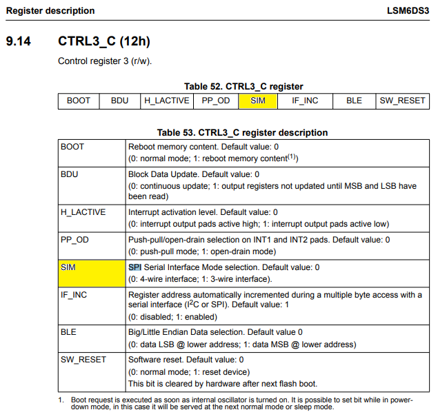

2019-05-31 12:58 PM
Answer in the spec. Read well...

2019-05-31 3:05 PM
Yep, this sensor default after power on to 4 wire mode.
If you want 3 wires, you must write SIM bit first, then do the reading.
2019-05-31 3:07 PM
I want 4 wires and the settings are on 4 wires but i still get no data.
If you look on the osziloskop-Pictures you will see that something is wrong.
