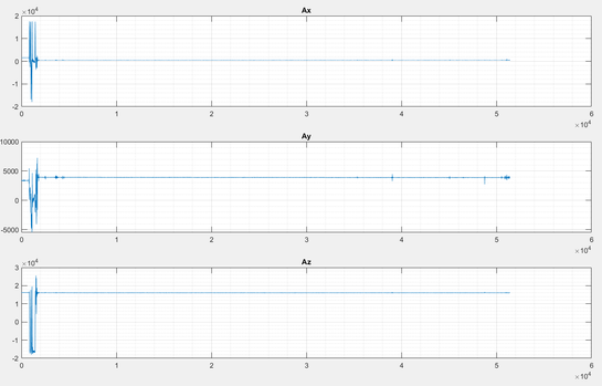

Here is what I can see when I plot Gyros and Accelerometers Datas.....

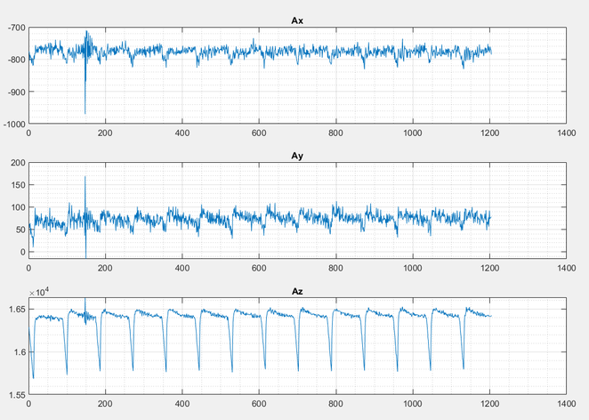

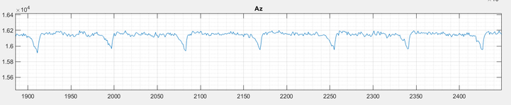

First LSM6DS3 is stand still on a plate, then I can see some kind of pattern on signals, this pattern is the exact period of FIFO FTH !!!! How can it be ???? (figure : FIFO FTH = 1032words of data, so 1032/6 = 172, spikes appears every 172 samples) We get the same with half FIFO FTH (516words, spikes appears every 86 samples )

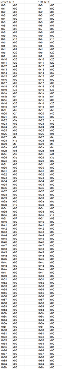

I post you my configurations for both DRDY on INT1 and FTH on INT1
To be precise it is the complete map of LSM6DS3 registers

The program using FTH on INT1 still show a pattern every FTH samples....(here every 86 samples FTH =0204h (516d) 516/6=86, SDCard write is done just after. Oscilloscope shows a 3.46-3.54 volts between LSM6 VDD and GND pins, with no variation
here is a global view...
only Az shows a significant pattern...

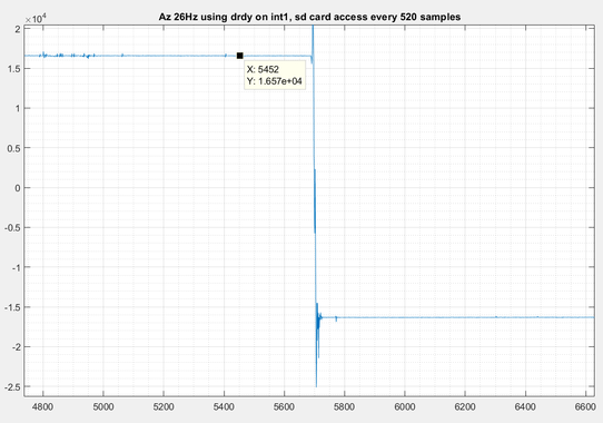

The other program using DRDY on INT1 does not show any pattern, SDCard writes are done every 520 samples (only Az is stored (from LSM6 registers 2Ch,2Dh))
