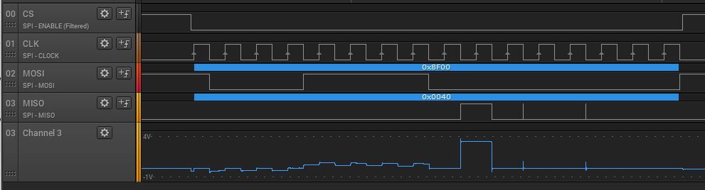

SPI Configuration:
  • SPI Freq- 100KHZ
  • Slave Select - Active low
  • CPHA- 1
  • CPOL - 1
  • bit order - MSB first
sent 0x8F00 on MOSI line and seen 0x0040 and it was random some times we are seeing 0x007F as a response.
