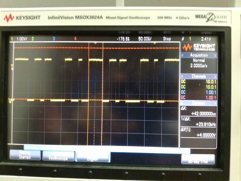

If I read it in my main while(1) then it start working, but interrupt generated in a strange way (picture attached.)

I change my acc to be 104 hz. Same picture.
If i don`t read Status_reg than i don`t see any interrupts coming.
So first problem is to read data inside interrupt callback. (but i can read it in main). Stuck in I2C, i cannot explain what the difference when i trying to read i2C inside interrupt or outside.
Second why interrupts are coming in different timing and data is always 0.
