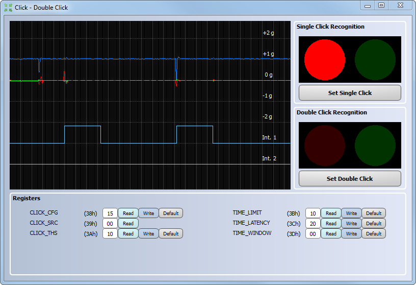

Unfortunately the complete configuration of the sensor is not visible from you code (for example used ODR?).
Anyway your configuration for click detection seems to me quite strict, and it is difficult to trigger the interrupt.
You can try following configuration (ODR=25Hz):
