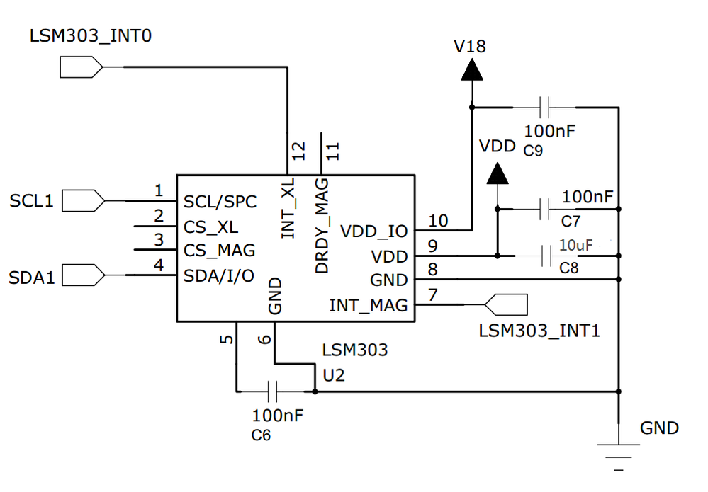

Can you share your schematic?
2018-05-22 8:57 PM
hi, Microslav B
this is our schematic.
2018-05-23 9:32 AM
The CS_XL and CS_MAG cannot be let floating, for I2C communication they must be connected to VDD_IO.
