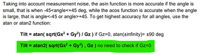

I was able to create an alternative heading vector using the atan2() equation mentioned in the last section of that document.
For people in future world, just plug in your mg values for x, y, and z where it uses Gx, Gy, and Gz respectively.
This will output radians, and you can convert to degrees by multiplying by 180/pi (57.296).
