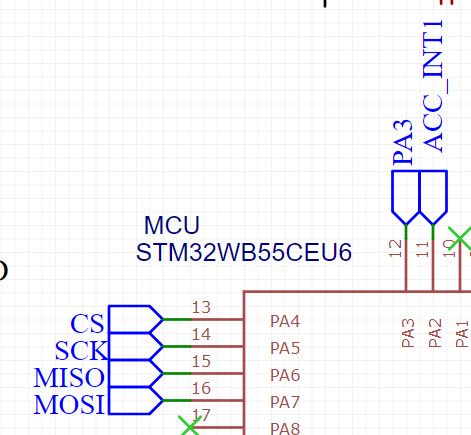

I'm using a STM32WB55CEU6 as SPI master.

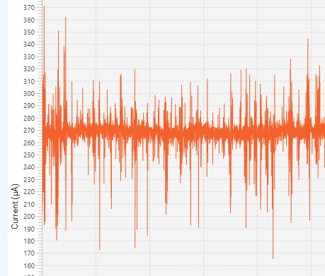

When the ISS3DWB is in low-power mode it should use 5-16uA, but I'm measuring ~265uA.

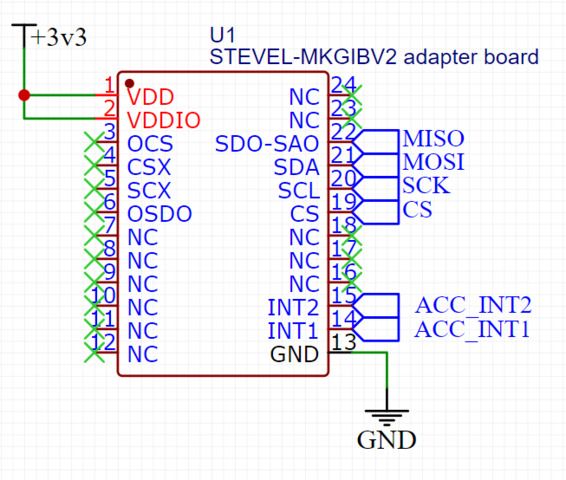

Schematic:
Measurement of ONLY the STEVAL-kit VDD-pin (ISS3DWB in Low-power - VDDIO pin connected to MCU VDD):

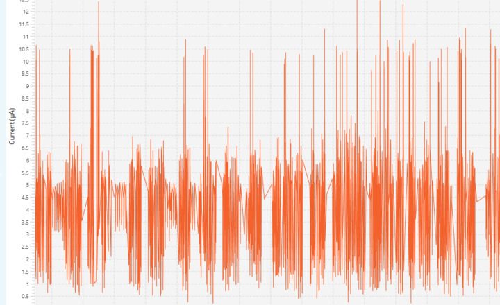

Measurement of the STEVAL-kit VDDIO-pin (ISS3DWB in Low-power - VDD pin connected to MCU VDD):

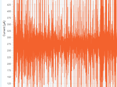

0693W00000Nt7M1QAJ.pngMeasurement of STEVAL-kit VDD + VDDIO in low-power-mode
I'm not sure I understand why VDDIO is drawing so much current - isn't it supposed to be the SPI voltage reference?

Vdd is 3.3V across the whole system. VddIO is connected to this *** well. Only for the "pure" VddIO meassurement was it isolated on the X-Nucleo-LPM01A meassurement pin.

i can definately tolerate current consumption of the SPI suring communication and sampling, but what bothers me is the current draw AFTER I put the IIS3 into "low-power-mode" and deinit the SPI on MC (2nd graph).
