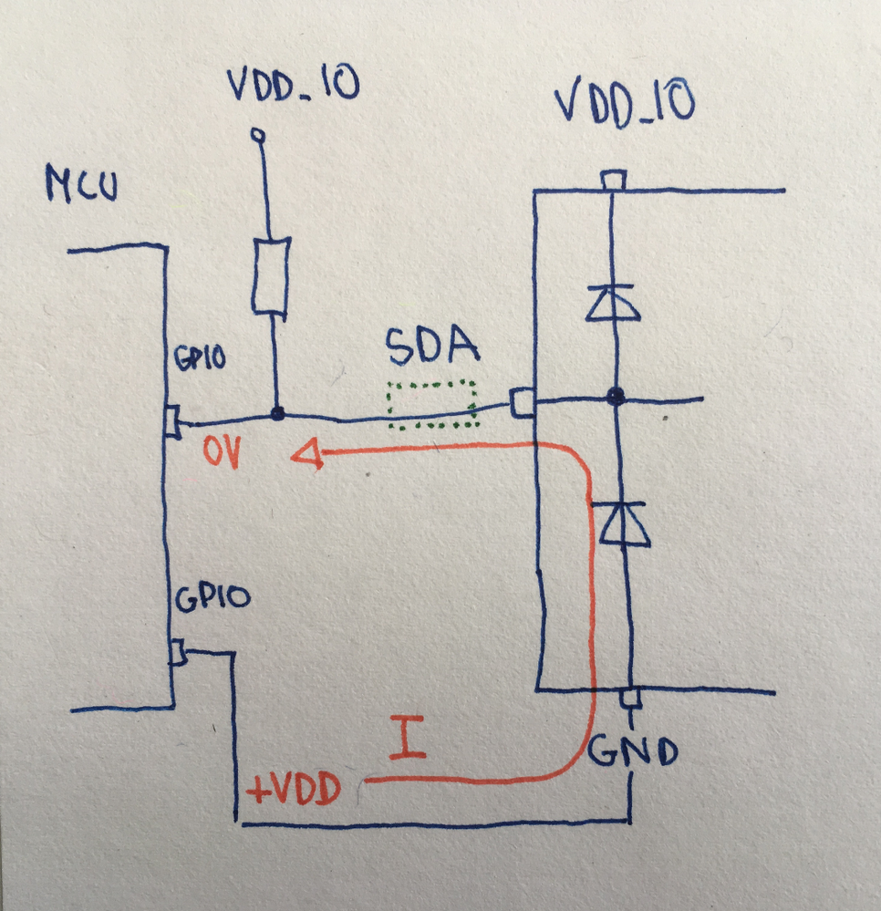

The problem is caused by internal ESD diodes on the SDA and SCL pins.
I tried to summarize the situation on the following diagram.
So when you put VDD on the GND pin and try to force 0V od SDA or SCL pin the ESD diode is open and there will be quite high current which could damage the sensor or the MCU.
The only solution I see is to add series resistor (green dots on the picture), but anyway the solution will create additional current consumption and also reduce the maximum communication speed.

We were able to get it working with GND switched to High-Z on the MCU and series resistors on the data lines. A communication on the i2c bus with the RTC is now possible with the LSM303AGR turned off. We have an additional current consumption of 100nA with the new ecompass, and this is way better than the 2uA of the sleep mode
