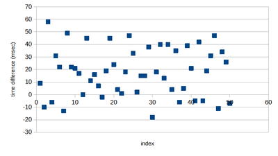

After a month in the quest to make it work, i reach the conclusion that the lsm303agr is not good at doing accelerometer measurement at 1hz. It's to wonder if their test it at this frequency!
I'm done my tests on 2 homemade boards plus one arduino with the STEVAL-MKI172V1 (which is the test board of ST).
Here below is the graph showing the time different between 2 consecutive samples, the board used is the STEVAL-MKI172V1: the configuration is simple (no fifo used) ODR 1hz, DRDY1 interrupt on INT1 pin. The dc constante of 1sec is remove, the plot is in msec.
as you can see if the odr was almost perfect i should have all the datapoints center close to 0msec but it not the case!
