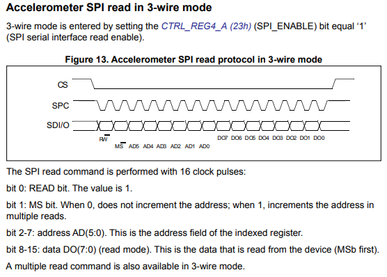

Hi @AAYKA.1 , can you check how you configured the SPI at master side (8bit or 16bit)? Did you perform multiple readings continuously? And after which event does the SPI go in timeout? Here below is the 3-wire SPI data pattern (p. 41 of the datasheet), please check if you followed all the indications. Appreciated if you can share the pattern analyzer data.
