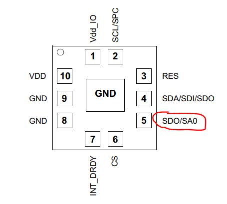

Hi @sadam.1 ,
did you properly set the SA0 pin on the two pressure sensors? This pin has to be set to "0V" for Sensor1, and to "Vdd" for Sensor2, and the I2C address changed accordingly.
Did you also try with another couple of sensors, just to exclude an HW / specific device related issue?
