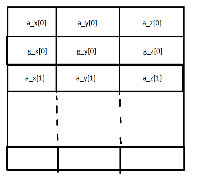

My concern is the following. Because there is only one common FIFO for both the accelerometer and the gyroscope, the samples inside the FIFO could be interleaved right? For example, the FIFO could look like this:
As you can see in the picture above, first we have an accelerometer sample, then a gyroscope one and then a second accelerometer one.
For convenience, let's assume that FIFO has only these 3 samples, therefore:
My question is if I issue a multi-byte read command to the OUT_X_G register like the following:
i2c_burst_read(data->i2c_master, config->i2c_slave_addr, LSM6DS0_REG_OUT_X_L_G, buf, 6); // 3 axes, 16bit values therefore 6 bytes
Will the device be able to pop the g_x[0], g_y[0], g_z[0] gyroscope sample from the FIFO, although it's not the first one and transmit it to my microcontroller? In addition what happens with the first sample which is an accelerometer one?
