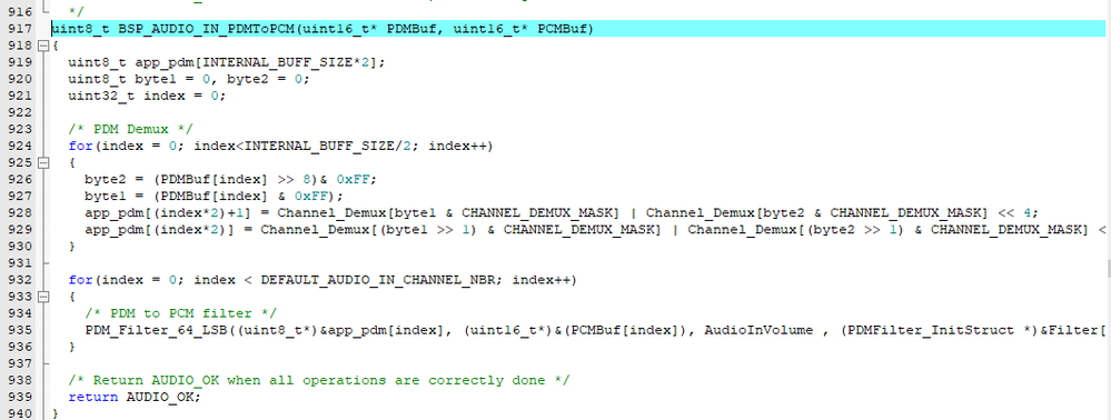

I'm using MEMS1 Microphone streaming project to record PDM data coming from 4 microphones and convert it into PCM data.
I'm wondering how I can access to the PCM data coming from each microphone.
From what I have seen so far, the output of the project is PCM_Buffer. As I want 48 kHz PCM audio, the size of PCM_Buffer is 48 kHz *4*1ms = 192 uint16. But the problem is that I want to separate the PCM data into 4 different buffers (for another project) and, if i understood correctly, the data of PCM_Buffer is mixed with all the microphones, I don't know how.
Any idea about how you would do it ? Thanks
