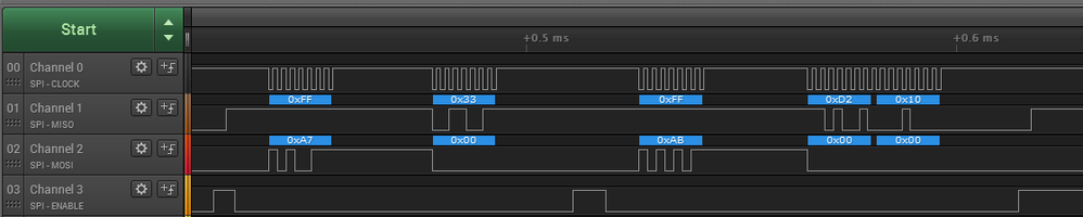

I have STEVAL-MKI183V1 connected to stm32l476rg NUCLEO. I have downloaded the C example code. Setup the SPI and the Interrupt pin using STM32CubeMX. With the help of some example code i hooked it all up.
I get correct value for WHO_AM_I (0Fh) register.

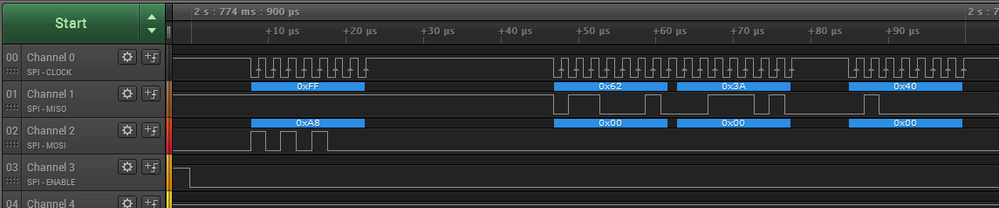

This is what i get on the logical analyzer. First one is the temperature and the second one is the air pressure.
I get 43.06 degC and air pressure of about 1027 hPa which puts me -120m underground. I am quite sure i am not underground and it is not 43 deg.
After reset I am using the default settings 10hz, BDU bit set. No change from the example.
What i have noticed is that when i apply heat to the sensor the air pressure goes down, while the temperature is more or less the same. Any advice? What have i missed? Magic spell, as long as it does the trick?
