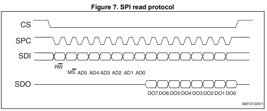

WHO_AM_I (0Fh) register value is 3Dh, while to see the OUT_Z_H varying try to enable OM[1:0] bits in CTRL_REG1 (20h). The SPI read protocol is the following one, so you have to send 16 clock shots and the SDI must contain the bit 0 (R/W) READ bit, which value is 1. For multiple readings the M/S bit has to be 1 too. SO you have to send the value 1F00h for WHO_AM_I reading. Regards
