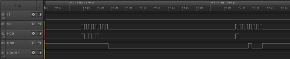

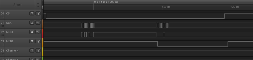

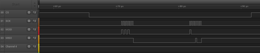

}LIS3DSH and STM
X L axis (adress 0x28)
X H axis (adress 0x29)

Polarity of SPI clock is actually HIGH. Set CPOL = 1 in your SPI configuration, then it should work :).
Also word size is 16 bit, look at datasheet figure 7.
Correct config for SPI is:
CPOL = 1
CPHA = 1
Word size = 16 bit
