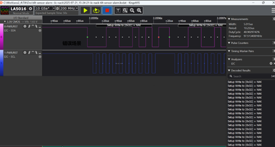

With logic analyzer, after 5mins ground SCL, the chip randomly cannot response with IIC even remove SCL grounding.
No response could not recover even cold reboot the chip.

For another abnormal behavior after 5mins grounding SLC, the axis data was incorrect, confirmed with logic analyzer.
When sensor was steady state on a horizontal surface, X-axis reached 1000mg. X-axis should be around 0mg.
