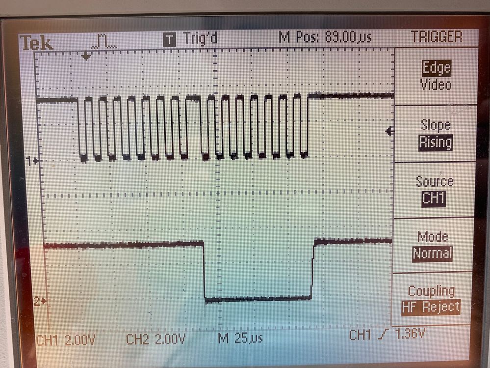

Then I connected the oscilloscope to the CLK, MOSI and MISO lines to check the SPI communication. The CLK and MOSI lines seem normal, but MISO only gives 0s.
I have tried reading every LIS3DSH's register in all four SPI modes and none of them returns anything apart from 0s.
Top channel is CLK and bottom channel is MISO.
The LIS3DSHs I have from older orders are working correctly in the same circuit with the same code. The only difference I can see is in the top letters. Old one is, if I can read ir correctly, 2804 DSH6 UOHM; while new one is 2903 DSHT XJDT.

Hi @jmartinezlahoz​ , from the oscilloscope scale it seems you are running at VddIO level of 4V. I suggest you to decrease the Vdd or VddIO and then try again the SPI communication. Regards

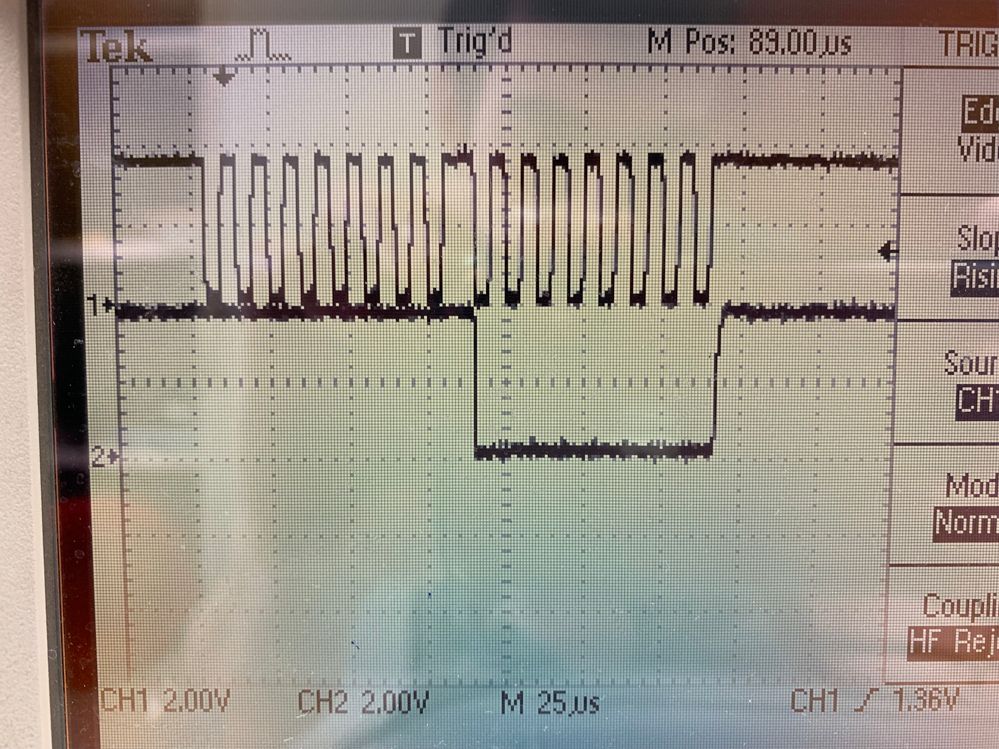

Thanks for the response, I adjusted the VddIO level to 3,3V, but it solved nothing as you can see.
In these photos I am using an external DC supply to test the communications. In the board I use a buck power supply, and I have ensured that it works correctly at 3V3. All the other components work fine in the board, including the old LIS3DSHs.

I tried with lower Vdds, but it still doesn't work. I bought 23 samples, I tried 6 or 7 of them, and none seem to work.
