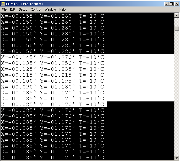

In the meantime I give yout another example on how data changes dramatically and suddenly without any motivation
Moreover, this behavior happens going down only with the temperature and NOT going up
Thanks in advance
