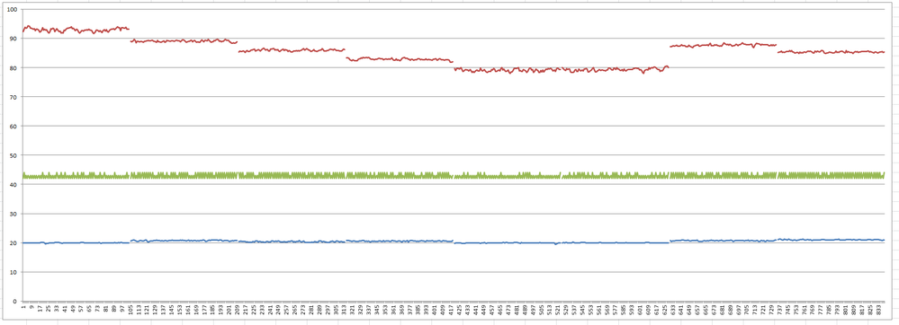

Hello! I am R&D inclinometer based on LIS3DHH. Firstly I started my works with LIS2HH12 as MEMS accelerometer due to his best accuracy and resolution. I wanted to get accuracy about 1-2 angular minutes. All was good when I turned on almost all internal filters and using software moving average. Even with 7 sec response it was ok for my solution. But after few experiments I discovered problem with temperature stability. I decided use internal temperature sensor to compensate temperature coefficient and started temperature experiment (first with termal camera, but after without, because was a lot noise from camera). And I can't find out temperature coefficient for that. Next figure shows angle for one axis (red), temperature from internal sensor (blue) and reference signal from another special inclinometer. So, angle changed unpredictably on different days.

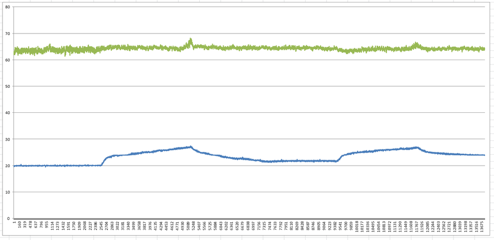

Next figure shows one angle (green) and temperature (blue). Here some unpredictable overshoot.

Can you help me, how I can solve temperature stability problem in LIS2HH12 or accuracy in LIS3DHH. Maybe better to chose another accelerometer for inclinometer solution? Is it possible to have stability angle with 1-2 angular minutes accuracy with MEMS technology?
