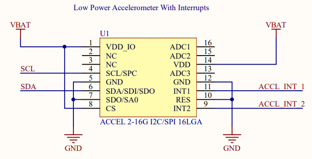

I have a custom board that includes the LIS3DH. With the LIS3DH not populated, my board uses 0.009mA, but with the LIS3DH populated and not configured, it uses 0.135mA.
According the data sheet, it should be 0.011mA. The data sheet also says the LIS3DH is set to "Power Down Mode" by default.
Attached is the schematic of the LIS3DH on my custom board. Is it not connected correctly?

2019-12-13 4:08 AM
Hi Steve, I think that it could be mainly related to an HW root cause. The datasheet says at p.9: SDO/SA0 pin is internally pulled up. Refer to Table 3 for the internal pull-up values (typ.). If you connect the SDO pin to GND you create a path (even if not direct) from VBAT to GND causing an over-current consumption. Regards
