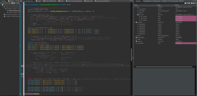

I am utilizing an H563ZI board.  I consistently receive identical values for acceleration across all axes, which is not expected behavior. Furthermore, these values remain constant without variation. Additionally, my attempts to utilize the driver provided on GitHub have also yielded unsuccessful results.

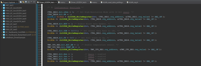

Attached are screenshots illustrating the debug output of our program. Figure 1 depicts consistent values for acceleration across all axes, while Figure 2 showcases the initialization registers where we suspect the issue may lie, particularly in the inadequate initialization of certain bits. 
Figure1: acceleration data
Figure 2: initialization
That's what I did (Refering to "Accelerometers need to be enabled in LIS3DH_CTRL_REG1"), but I don't know why it's not working.... My initialization registers are:
