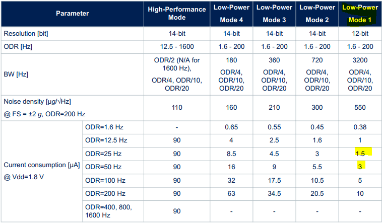

2020-01-29 12:31 AM
Hi @Eleon BORLINI ,
Thank you for those information.
Our power budget on accelerometer is around 3uA in 3V supply voltage.
After some evaluation, we will try to use 25Hz or 50Hz ODR as shown on below image.I would ask if you have similar data of current consumption in 3V power supply for highlighted mode?
Thanks
2020-01-29 1:49 AM
@Dillah, of course going in LPM will help the power budget requirements. The curr cons for 3V in LP1 at that ODRs is about 2.5uA with ODR 25Hz, so this is the condition in your case. Please note that the resolution lowers from 14-bit to 12-bit, you should have to check if you can detect the single/double tap in a good way. Regards
