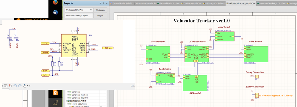

Anyway can you please share you schematic, at least the sensor part, I can look at it.

Thanks for your prompt reply. Of course I can share the schematic with you.
As you can see, I have two external pull-ups for I2C. I used 10Mohms to additionally reduce leakage current and it I2C is working properly with them. Between MCU and the accelerometer, there is only I2C interface.
Is there anything you can suggest me? How could I disable internal pull-ups?

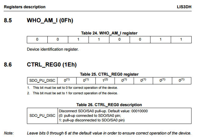

There will be a current from SDO/SA0 pin to ground in your circuit, because you connected the pin to ground. According to datasheet the current should be higher than 70uA, but anyway try to disable the internal pull-ups in CTRL_REG0 register. Please check chapter 8.6 in the datasheet.
The pull-up for SDA/SCL are very high, you could have a problem with the communication. The recommended value for I2C pull-ups is 10kohms.

I'm sorry, the current from the internal pull-up is actually very close to what you measure. For the Vcc=2.5V the typical value of internal pull-up on SDA/SA0 pin is 30.4kohm. So the current should be 80uA. It is very close to you measurement. I believe that disabling the internal pull-up will solve your issue.

Yes, the current consumption will be decreased also if you connect the SDO/SA0 pin to Vcc. Inside the LIS3DH is pull-up resistor, so if you connect the pin to ground the current is flowing from Vcc trhough the pull-up resistor to ground, on the contrary if you connect the pin to Vcc there won't be any current as the voltage is the same on both side of the pull up.
I checked your link and the who_am_i register is described in chapter 8.5, CTRL_REG0 in chpater 8.6. Here is a screenshot, it is page 34.
The new version of the datasheet was published recently, so maybe that is the reason why you see different version. Please check it now.
