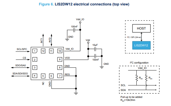

Hi @MSimo.1 ,
regarding the hardware/schematic configuration, are you directly connecting the STEVAL-MKI179V1 board to your application processor? And are you measuring this increasing current consumption just tiding the Vdd_IO to the 3V3 via the pull-up resistors (which value?), or during the I2C operation? In this second case, it is normal to see a current consumption increase since the toggling I2C lines (going up and down from 0V to 3V3 through the pull-up resistor). If for example the resistors' value is 10kOhm, you'll experience a current consumption of 330uA

2020-11-10 2:39 AM
Hi @MSimo.1 ,
>> I've connected VDD and VDD_IO directly to 3.3V. Isnt it indented that way? i cant find anything in the datasheet or in the application note (AN5038)
You can find some Application hints for example in the LIS2DW12 datasheet, p.16, where the pull-up resistors are declared and the 10kOhm value is suggested.
>> Iam reading the value of 330uA in the Standby-mode.
This could be caused by the direct tiding of the SDA-SCL I2C pins, since the only internally pulled up are SDO/SA0 and CS pins (see datasheet, p.4).
Is it possible for you to check the current consumption in standby-mode with the pull-ups mounted?
-Eleon

2020-11-10 3:21 AM
Yes you can try this way.
But are the other pins connected as shown in the above (with CS high? Or, if the CS is low, you can disable the internal pull-up resistors writing the CS_PU_ DISC bit of the CTRL2 (21h) register).
You can also try with reducing the VddIO (for example from 3V3 to 3V), keeping the Vdd at 3V3.
-Eleon

2020-11-10 5:26 AM
well, it could be a device-related issue, but you tried two sensors, so I believe it is something related to the connection / hw initialization.
you write that the SD0 pin is tied to GND, but please note that this pin is internally pulled up: this means that there could be a resistance path causing the current to flow down from 3V3 to 0V through it. Can you please try to disconnect this pin?
-Eleon
2020-11-10 5:41 AM
THIS IS THE PROBLEM!!!
thank you!
the Datasheet says, that this pullup cant be deactivated:expressionless_face:
looks like i have do adjust my code and create a new PCB........
thank you very much for your help!
