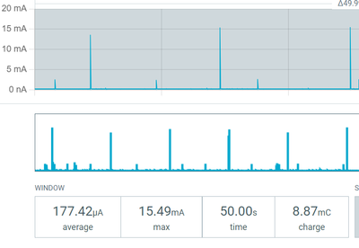

This is the current absorption with the sensor fully resinated and the accelerometer powered up in sleep state:
Normally, its current absorption is under 10mA, and if I power off the accelerometer its absorption returns to normal ranges.
Do You have te possibility to open the .ppk2 extension files?
Is there a possibility to have a private ticket discussion?
Thanks in advance.
