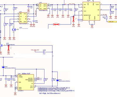

I am using lis2dw12 accelerometer connected to esp32s3 and recently have got a situation which is blocking for esp32s3 to read status registers of accelerometer when LIR =1 (latched mode). I put accelerometer on stationary mode and routing the intruppt to INT1 which resets my esp32. Interrupt is working fine but when I want to read tap_source or wakeup_source or in general ALL_INT_SRC ( not pulling them. only one time) to detect the reset reason on my esp32 side, It will be hanged sometimes until esp32 watchdog happens and from that point the status register are readable since i2c is reinitiated I guess. Whould you mind please help me to underestand why acccelerometer get frozen?

However, can you provide us your project schematic (which ESP32 pin are you using to communicate with our sensor), and the line code in which you detect the interrupt event and the following few lines?

Sorry for my late response due to the holidays. I actually found the problem but I have no proper explanation for the reason of that. As I mentioned above I only try to put the accelerometer in the stationary after each esp32s3 power on. Accelerometer can wake up the esp32s3 since the INT pin is connected to esp_pwr_on pin( you can see in the schematic). The faulty scenario happens when I set accelerometer in stationary + latched mode enabled(LIR = 1).

esp_en goes to esp32s3 pwr_en pin
