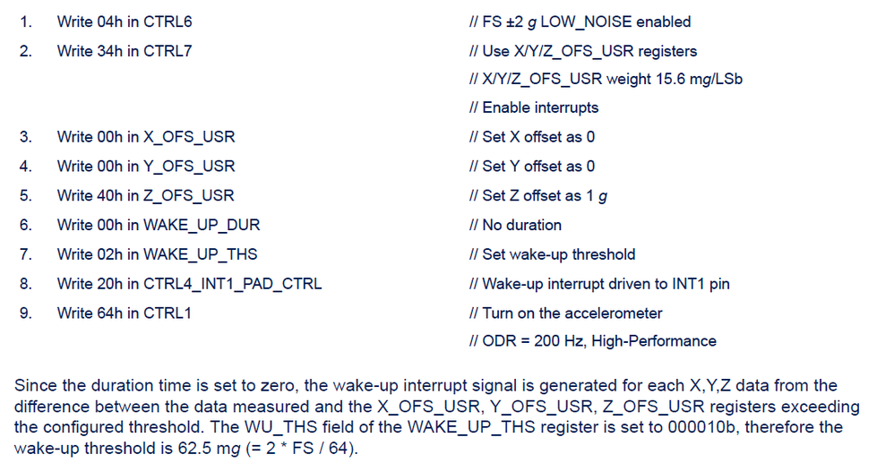

I am working on the LIS2DW12 Sensor with Wake-up feature.
Issue :

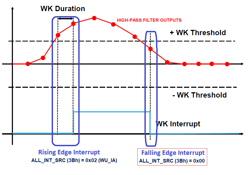

Getting Zero on ALL_INT_SRC (3Bh) read while Falling interrupt occurred.
Description :
Configuration :
Operation :
Why does Falling Edge interrupt show Interrupt status as Zero?
