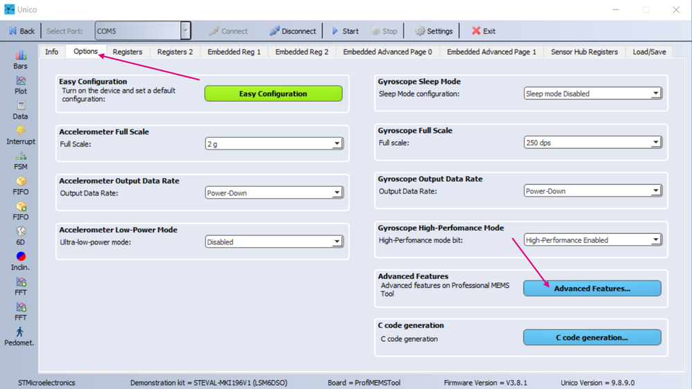

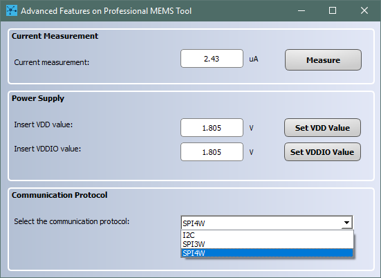

Hi @Lmile.1​ ,
I just got the answer from our experts and well... it's possible at GUI level!
For many devices, IIS2DH included, in the "Option" tab you can find a button “Advanced Features for Profi�?, that allows (also) the communication protocol change.
Please check the picture below for a guide:
0693W000008wsmgQAA.png0693W000008wsmqQAA.pngIf my reply answered your question, please click on Select as Best at the bottom of this post. This will help other users with the same issue to find the answer faster.

Hi @Lmile.1​ ,
you should be able to find it in Options --> Advanced features as shown in the picture below:
-Eleon

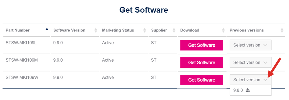

You can however try downloading the previous version of Unico (for Windows, for example) from the st.com page:
-Eleon
