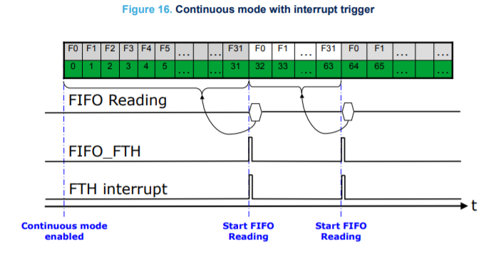

Eleon BORLINI
Hi @Msaga.1​ ,
continuous mode works if you are able to synchronize well the reading from the FIFO with the writing in the FIFO, with SPI speed much higher than ODR frequency, which is the rate at which FIFO fills (according for example to Table 28 of AN5038 application note.
If you want to read a batch of 10 samples (say from t=1 to t=10), and keep on the FIFO filling, and then read another batch of 10 samples, and so on, being sure you are collecting batches of consecutive samples, than you should use the FIFO mode with the proper FIFO threshold: when this level is reached, you can start depleting FIFO with SPI (faster than ODR). If you want to reset FIFO content, you can use the Bypass mode, that clears the buffer; then write again the FIFO Mode bit, so the reading can restart from when it was interrupted. If the reading phase is sufficiently fast (less than 1/ODR), you shouldn't lose consecutive samples.
But I would suggest you to use the Continuous mode with a fast FIFO reading phase.
0693W00000BdZXbQAN.png-Eleon

Hi Maya,
the FIFO threshold is measured in number of samples, so you don't mind the actual 1/ODR period. However, it can be important if you want to compare the SPI frequency speed and the ODR, and use the SPI to rapidly acquire the FIFO buffer, so that you can be faster than 1/ODR and you don't miss samples.
If you activate Bypass mode, the FIFO is not operational: buffer content is cleared, output registers (0x28 to 0x2D) are frozen at the last value loaded, and the FIFO buffer remains empty until another mode is selected (App note p.38).
>> how will it insure that the reading will start from the same place?
If SPI is much faster that ODR (e.g. 10MHz compared with 12.5Hz), you will be confident that the reading of the buffer will occur before the next FIFO data is written.
>> That is what I want to do, how do I influence the reading speed?
You can do it by changing the SPI frequency.
-Eleon
