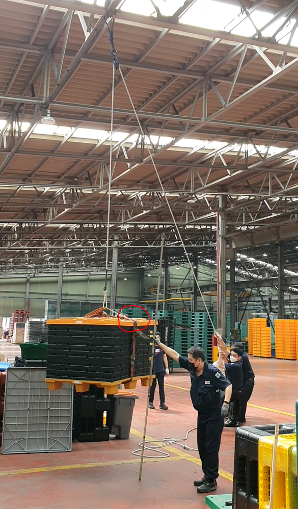

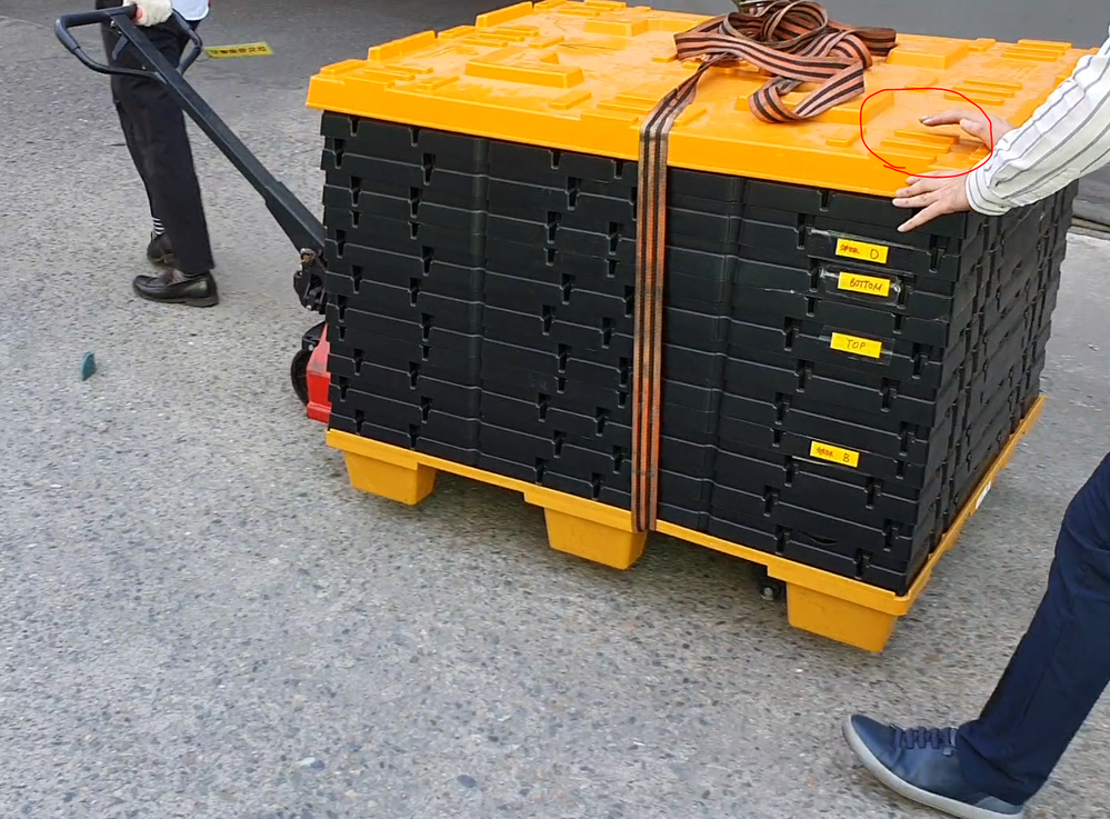

2021-07-20 5:42 PM
Thank you for your reply.
I've two more questions about our test case.
Thank you for your support.
2021-07-22 12:46 AM
Yes it is possible to get higher acceleration values from a shock impact than in case of free fall, it depends on the intensity of the pulse. You have to choose the correct full scale to be able to detect these shocks, for example the 16g FS.
The values X = 14496 , Y = 19568 , Z = -30944 and X = -22576 , Y = 9136 , Z = 32640 are above 2g: are you using higher full scales?
Tom
2021-07-22 1:08 AM
Thank you for your reply,
I believe we are using 8g on the values [ X = 14496 , Y = 19568 , Z = -30944 and X = -22576 , Y = 9136 , Z = 32640 ].
Are there any problem if we use 8g on setting?
2021-07-26 1:10 AM
No, no issue, it is an available FS. Probably better to use 8g than 2g in you case, in order to detect mechanical hits.
Tom
