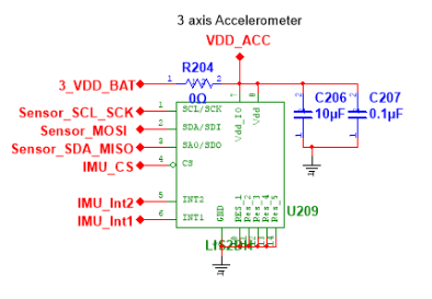

Hi @Eleon BORLINI​, I have put the resistor between battery voltage and Accelerometer VDD. PFA the schematic. R204 is my 0 ohm resistor.0690X00000BudvRQAR.png
Are there other connections on VDD_ACC net? To summarize the issue, all the 1000 board have this R0 component but you found an over-current consumption problem only on 50 of 1000 board. On these 50 boards, when you remove the R0 and substitute it with a direct short (solder bridge), the issue is no more there. For this reason, the problem should be in that part of the circuit... You have to be sure that the resistor is not overlapping on other parts of the PCB (such as vias, exposed lines etc).. What I can suggest you is to un-solder these R0 resistors, check if they are effective 0 Ohm and then solder them again on the issued pcb. Regards

There are no other connections to the VDD_ACC net.
The R0 resistors are effective 0 ohm. Also, in a few boards I bridged the resistor with solder, then current dropped to normal.
We are checking our PCB Design and possible fabrication/SMT issues that might have caused this problem.
