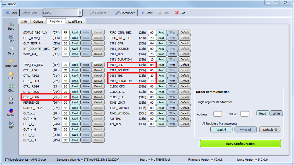

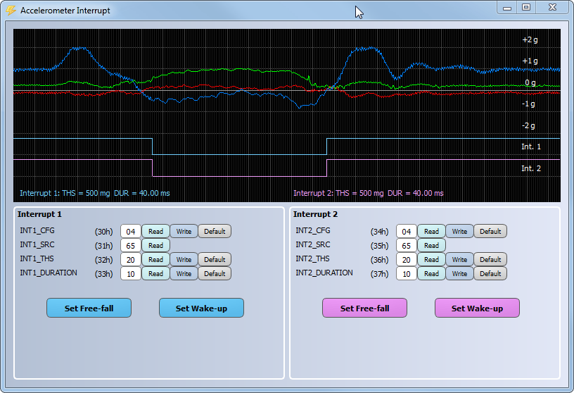

2017-03-10 2:30 AM
Please see below configuration of LIS2DH. The registers related to INT2 and Interrupt generator are highlighted.
Please adjust the threshold and duration parameters according to you needs.
Here is an example, showing functional interrupts.
2017-03-10 8:32 AM
Thank you very much, I will try it the sooner I can
2017-03-15 3:22 AM
I tried your settings and the interrupts are working now.
