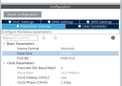

Again: did you set data size to 16b ?
here:
+ your data in software also 16b , but: command/send is only in upper 8b , resonse/receive is only in lower 8b of the 16b words.

Yes
The problem remains the same

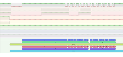

this what i get when i analyse my signals :
when the thing I am supposed to send is {10001111, 0}
 not So the first clock tick is not supposed to be here because the count of clock rise is 17 when it supposed to be 16

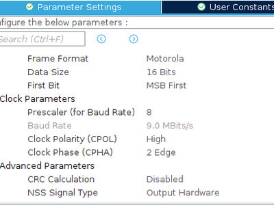

+ for LIS   - maybe need this spi setting: ( high+2edge )
always just
HAL_SPI_TransmitReceive(..)
1 x 16b word, for write set the upper/lower 8b (discard the receive);
for read, as i wrote,  data in software also 16b , but: command/send is only in upper 8b , resonse/receive is only in lower 8b of the 16b word received.
this is my configuration already ;)
