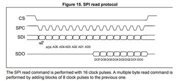

The protocol for SPI transmission is
But my Register always equal to 0. ret = HAL_OK.

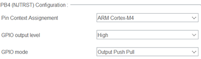

my CS:

Have you used a logic analyser or oscilloscope to see if what's actually happening in your hardware matches the protocol spec diagrams you posted ?

Imagine : the receiving chip expects a sequence, as given in diagram.
But you send another, in two parts...could work, or not.

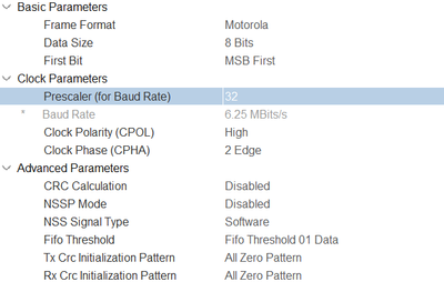

So set it to 16bit SPI data size.
Ahh, + set : Motorola, with NSS = hardware , to get matching /CS signal. (Then no need to set it in software.)
But everywhere I see, bit for the adress and  it says 8 bits because each communication is 8 bit long (8bit for the adress, 8 bit for the data but the slave expects 8 bits for the adress and 8 bits for the data and it is separated). If i put 16 bit long the slave will wait for 16 bit for the adress and 16 bits for the data no ?
If i do that that means i will not have to toggle the pin every time ?
Where you "see 8bits" ?
in your pic:
I see 16bit sequence here.

Read underneath the picture, it is 8 bits the data size
But now the problem is that when I am in reading mode, after transmit receive, the receive data are equal to the transmit data...

No, I have changed it and i always have hal_error and i have worked with another accelerometer wich description of SPI was the same and the data size was 8
