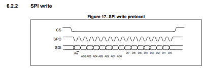

The protocol for SPI transmission is
But my Register always equal to 0. ret = HAL_OK.
I don't understand why :)
Can you help me
27 REPLIES 27
Andrew Neil
Super User
So have you used a logic analyser or oscilloscope to see if what's actually happening in your hardware matches those ?

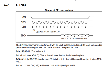

In your timing pic , for SPI-read , it shows like this;
transmitted word/upper 8 bits is address, response (read=answer) comes in received word, lower 8bits ;
so you always have to do a (16bit) word transmit/receive , and set the important byte (= address), and in received word only use the lower byte (=response).
